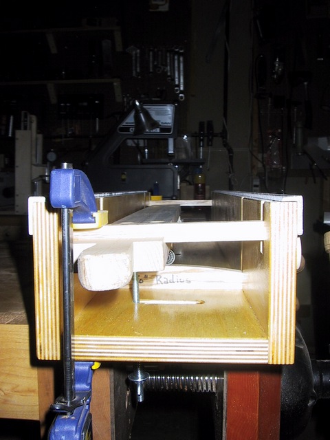

Mattia...Here's the scoop on the 16" to 24" compound radius setup. I made up the 24" block and set it in place with the 16". I measured the clearance along the length of the carrier board and it's consistent from end to end. While I don't have the time to do an actual FB I'm fairly certain that it can be done effectively. Check it out:
It should work fine for your electric FB's.
Good luck and take care of the arm!
